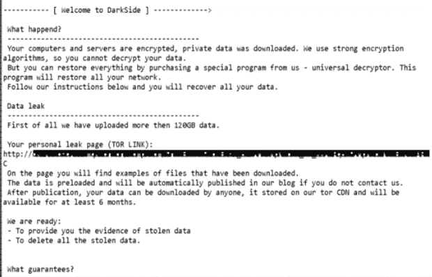

Below is a copy of the DarkSide demand from the Colonial pipeline attack.
DarkSide group ransom note.
